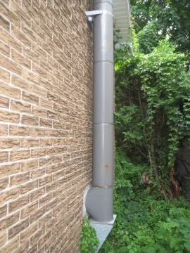

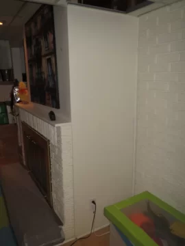

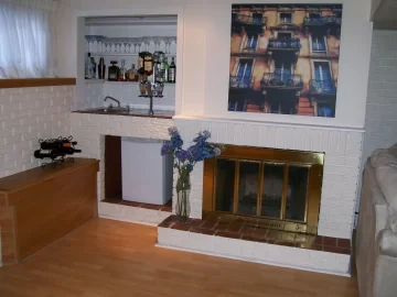

The current fireplace is a Selkirk model 832 from the early 1970's, whcih came with the house when we bought it about 6 years ago. We have never used the fireplace as the chimney was pretty rusted out when we bought the place. I originally bought a stainless steel chimney second hand, but in good shape, planning to replace the existing one, but never got around to it. Now the wife is compaining that the basement, where the fireplace is located, is too drafty in the winter. Like many of you, we had a long and hard winter this past year, so now we are looking for options to replace the fireplace and/or chimney. Our options include an insert (wood or natural gas), a new fireplace install or possibly just replace the chimney.

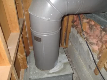

Of course, every company we contact recommends removal and new install, but that is $5-10k and it will be impossible to match the brickwork with the rest of the basement. You can see from the attached pictures, most of our basement is brick, including the fireplace. When we moved in, we painted the bricks and installed new floors, so I don't want to go messing with a new install now if we can avoid it. However, the feedback I got in the other thread, says I can't do an insert due to the issues with the way the current fireplace is installed (glass doors, but those can be removed) and a 90 degree (T) connection to the chimney, see photos.
Taking all of this into consideration, I am proposing to take out the old firebox and chimney out the wall to the right of the fireplace (see attached), and then insert the new gas unit behind the brick. The models I am looking at now are the Regency Horizon or Panorama (HZ33CE or P33CE). These models are about 29"x21". Are there any other models that you could think of that would come closer to filling the hole (37"x26").
