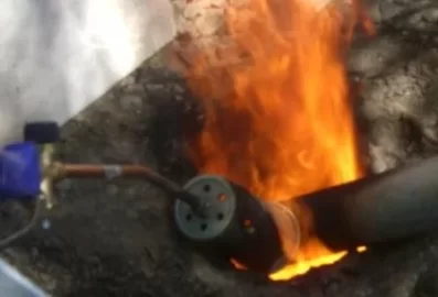

Then I decided to try to burn it out with harbor freight propane tourch wand. 4 hours of burning took me down 3 inches. Still no luck.

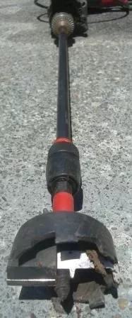

After some research I bought a 2 9/16" wood auger and put it on an 18" chuck extension (seen below). 10 minutes later I had cored the wood plug with a hole big enough for me to break out even the wet wood with my bar. Job done in 30 minutes.

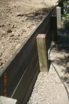

Once the holes where clear of wood, new posts just dropped in. The rest of the retaining wall was up on 30 minutes and back fill done in 20.

BTW, after drilling the hole in the wooden plug, I use a shop vac to suck out the wood dust. It also does a good job of getting out any rocks which may have fallen into the hole. If you hit a rock with that bit - game over and its time to swap in a new blade. That was an important feature of that bit - the fact that new blades and center tap screws can be added if they wear out.

Only issue might be from cooking the post hole mix, and weakining it with heat. once concrete gets heated past a piont it tends to get very brittle/weak. probably just fine though. not a strucual wall or anything!!

You are correct. In fact I "tried" burning it out but it didn't work. From now on I will be boreing the wood out with the auger.
