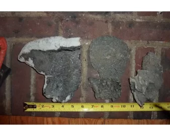

My wife and I bought a house last fall with several wood burning fireplaces. This came in handy when the furnace didn't work for 4 days of subzero temps. Little did I know until spring the main fireplace had rock hard glazed creosote lining the entire flue. Luckily we didn't burn the house down during those cold nights. My question is has anyone seen creosote this thick/hard and how long would it have taken to build up this amount? Seriously....I searched the web for similar pictures and found none. For reference, the chimney is on an outside wall and 25 feet tall so it may have built up faster than normal. I'm putting a wood insert in and had to slide a ice pick down the side of the flue to separate/break the creosote off which worked if anyone else is looking for a way to remove the glazed creosote.
