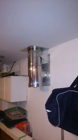

That is exactly how mine is installed. Not a question or concern from either the installer, or the inspector.
This goes from the stove room, through the wall to the garage, up through the garage ceiling, the garage attic and through the roof. Then, it goes up another floor on the outside and through the eave on the second floor.
BrianN....that is beautifull. That is exactly what I want to do someday. Super easy to sweep, and it gets some of the benefits of not being exposed to outdoor temperatures and wind, except for the cap of course.
A quick question. Have you ever measured the temperatures on the outside of the chimney pipe? I've always been curious about how much heat these chimney pipes keep inside.
BurnIt13. Just waking up, at the end of my burn and the temp on the T is not much. Arounde 12::C (53::F). I will check again once I reload and get her roaring. Although, will not be running too hot today as the outside temp is only -5::C (23::F)
I can't see it getting too hot as it is double walled, insulated. It definitely does not add much heat to the garage.
