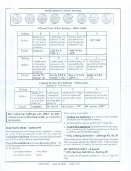

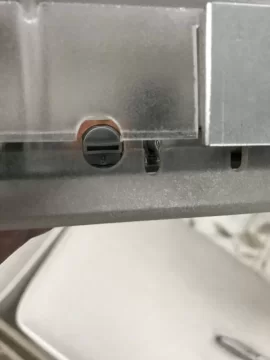

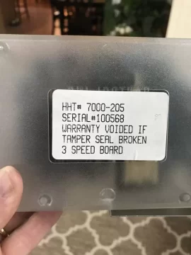

hi all. I just picked up a sante fe. Can anyone confirm the setting for the control box. It looks like it's set to 6 as you can see in pic. Not familiar with these stoves
