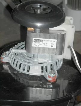

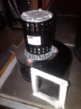

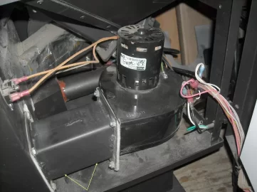

    I have seen three different convection blowers in the Saranac
    1. Squirrel cage convection blower with all black Fasco motor case - I have heard wheel bearing noise on this one.
    2. Squirrel cage convection blower with black and silver Fasco motor case - I have heard vibration with crimpings not secure.
    3. Squirrel cage convection blower with open Fasco motor with no case - This is the latest upgraded blower replacement with no issues so far.
    If you need the upgraded blower, please PC (Private Conversation) me with your email. Thanks
    1st pic
    Yellow arrows show snorkel that smokey mentioned
    2nd Pic
    3rd pic
