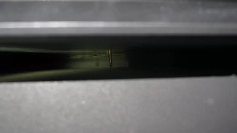

Sounds like what happened. I do have some mediocre pictures that might help illustrate the question.
screwed up my firebox screwed up my firebox
yeah that is not a problem at all

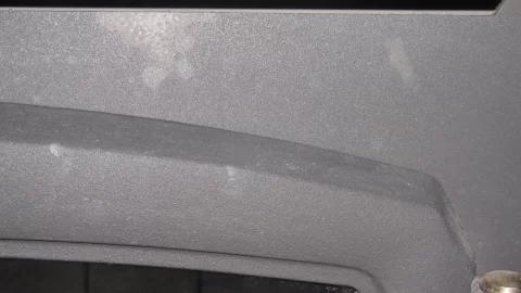

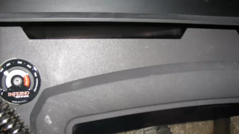

I burned a fire every day since Thanksgiving and have noticed some discoloration near the hot air vents. It seems like minor dimpling in the metal
where the paint didn't adhere from factory. I have some spray touch up paint on the way for some scratches occurred during delivery. Should I try to touch up this area too? I have pics that show the two spots.
Yes, I would lightly sand the area, then fine steel wool. Clean with alcohol then feather in the touchup.

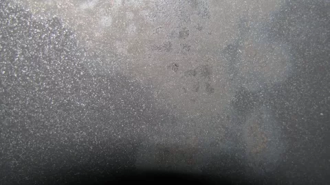

Is the minor pitting or dimpling visible in those pictures normal? I thought that caused the paint to not adhere through the burning season and not the high temperatures. I run a fire up to 650 degrees once a week and average 450-550 degree burns to keep the creosote to a minimum.
It was my impression that high temperature paint has a much higher heat tolerance.
Might have been poor surface prep and cleaning before they painted the stove. An oily hand smudge can do this.
Reactions: overnighter
Might have been poor surface prep an cleaning before they painted the stove. An oily hand smudge can do this.
My first thought was one of the kids touched it and had something sticky on their hands (when the stove was cooled off, or I would've heard about it from the wife). I've tried to wipe it off but the paint is gone. What you say echo's my first impression. From the factory smudging makes much more sense.
