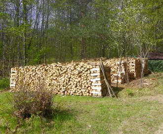

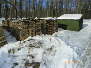

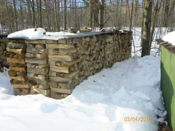

    Charlene, your husband would be correct if the entire pile was covered. Occasionally we see some crazy folks do that. By covering the whole stack, that leaves no way for the moisture to evaporate and evaporation is what we need. We usually do our splitting and stacking in the spring. Then we leave the stacks uncovered until early winter (before the snow flies).
    However, in your area, I would advise you to cover the tops of the stacks right after stacking. The reason for this is the amount of rainfall you get in your area.
    Below are 3 pictures. The wood freshly stacked, then the other two were taken the following spring or late winter. The wood is top covered with old galvanized roofing. Then we throw some of the uglies or bad wood on top to hold down the roofing. One can also screw it down to the wood pile itself.
    To dry the wood properly is it best to stack it off the ground, out in the windiest spot you have on your place. Wind is more important than sunshine but adding some sun is good too if possible. If you don't have multiple years worth of wood on hand, then stack it in single rows and stack it rather loosely. This will allow for better air getting through the stack. Leave a few feet between each row if possible.
    Now the idea too is for you to be 3 years ahead on your wood piles. You'll never be sorry for doing that either and you'll actually use less wood to heat your home.
