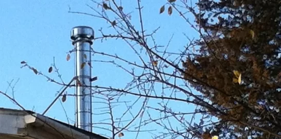

One last pic from the ground.

Well done sir. Just did my second install with the Selkirk SuperVent as I too found it to be a quality product at a competitive price. Your carful planning paid off. I find myself always catering to where I want the stove vs where the stove will fit. Both times involved headering off rafters and/or sheeting adjacent trusses to make way for my chimney with proper clearances.
Enjoy the warmth, you have certainly earned it.
