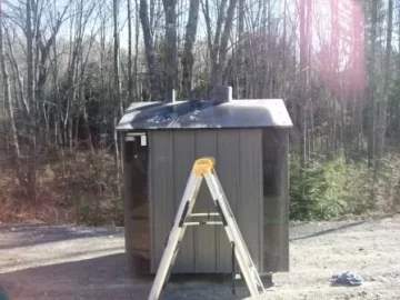

Well, my Sequoya was delivered Saturday morning and my plumber and I installed it yesterday. Last night was the 1st time I had a chance to run it. I woke up this morning and the temps were down in the house and the boiler was at 120. OOPS! I was trying to heat my 2700 sqft home as well as run a 155,000btu modine in my uninsulated barn. I guess I expected to much out of the boiler and was too ignorant to figure out that I was wasting more heat in the barn than it would to heat my entire house. I spoke to Rick over at Sequoya, who by the way, answers the phone just about everytime I call. he got a chuckle when I explained what I was trying to do and he explained that the E3300 will hold around 300lbs of wood which equals around 1.8 million BTU's and I was pushing over around 1.5 mill with the modine running constantly. Lesson learned! Tonight I shut the modine fan down and will let the pump just circulate and see what I end up with in the morning.

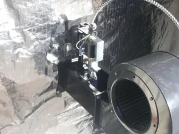

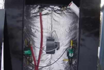

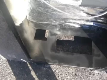

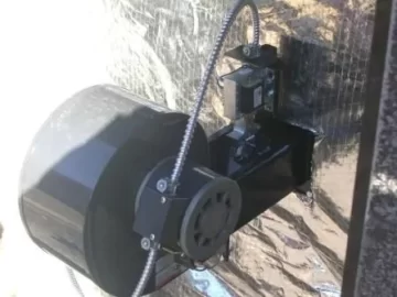

I'll post a few pics before it was up and running. I promise I'll take a few while it's going and with the back panel off. The pics below will show the hole I had to cut in the middle in order for the insulated pipe to come through. For whatever reason the manufacturer has 2 separate holes on either side but the pad dimensions show everything in the middle? The other pic shows the plain and simple squirrel cage blower which is hooked to the aquastat.
