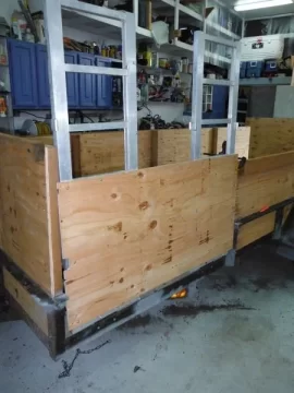

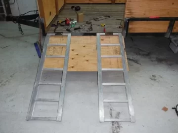

    Ramp in the front for the ATV.
    Not sure if I'll make a hinge & fold up.
    Take some welding to make that work.
    or
    Couple slots & use them as the gate.

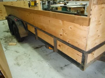

    Sides done. 24" plywood , 26" from the deck to the top edge
    Folding ramp tail gate next.

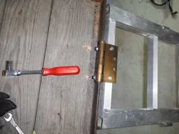

    If you don't have a welder, just bolt on a couple barn hinges to see if you like it. Should be plenty strong and you could always go back and weld something up later.

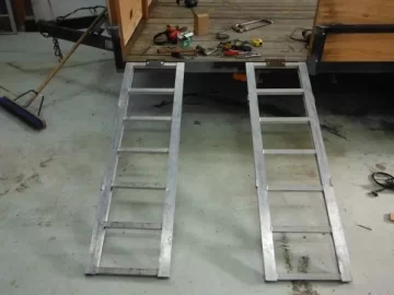

    Thanks for the idea.

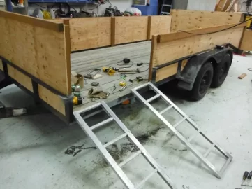

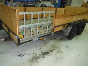

    4" heavy door hinges worked
    Just hast to support an ATV ( Oops & me, better add another bolt :) )

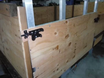

    Ramp latches:
