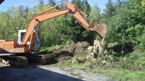

My stump digging was going nowhere without making a big ole mess and doing some damage so I tried the splitting method someone posted about recently. I hope it works better on rounds than it does on stumps.

Man the fuel used/cord to split goes up quite a bit if you use a hoe :)
Watch them overhead power & phone lines !!
Is that at the house or camp?
zap
That's home Zap. Definitely a tight spot Dave. My biggest concern was actually the well. Second was tail swing into the house on the other side of the driveway. But, was keeping an eye on those lines too even though I was well away from them.
I've taken out a lot of stumps with my backhoe. They just don't pull out. You have to dig a trench around it and sever the roots. That track hoe has much more power but you still can't just pull a real big stump out.
I'm gonna attempt splitting my big ash log with my hoe just to see what it does.... I think the log is gonna win. The Dolmar 28" will be waiting patiently.

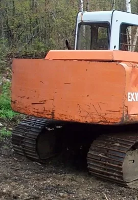

Maybe a picture of her rear end will make you guys happy :lol:

Is that ur machine? or did you rent it?

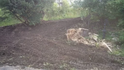

Yeah, I've dug my share of big stumps out with hoes big and small. Whenever I can, I do a quick dig on three sides and push the tree over with the hoe. By far the most effective way. This one had to be roped down though as it was over the house, power lines and road. I knew digging was a crap shoot at best because of the proximity of the well, driveway and that hill is a boulder field. I would just cut it flush but this tree was full of metal and had already taken a bunch of casualties. So, did the best I could with the hoe, put a sacrificial bar/chain on to clean up the top and will let time do the rest. A little more work with the rake today and I will be able to seed that bank.

Mine for a time. It was dying a slow death up at the camp in the gravel pit in the middle of the ADKs. I have been nursing it back to health while I get my lot cleaned up. Then she gets a for sale sign put on her.
nice to have. i could use one of those for a little while. must be fun to play around in as well.
Yep, 2 joysticks and 12 tons makes it feel like a video game.
a little flat for my taste
