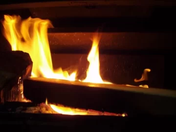

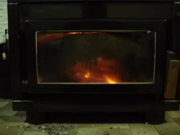

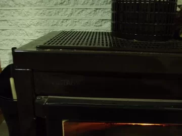

Thanks for your reply, I have checked/cleaned the flu - it was/is really clean, the cap was quite low so have raised it as high as I can. If I have the fire door open I can burn all my wood quite happily. However, even with kiln dried 4x2, once I shut the door (with the damper full open) the fire dies right down. The best I have managed to do is get the fire roaring with the door just open using the kiln dried 4x2 for around half an hour before closing the door. I can burn normal wood if I surround it with the 4x2. I have taken photo's and will try to post them here too. I would be quite keen to find a air flow diagram for the burner so I can see if its being blocked somewhere...
