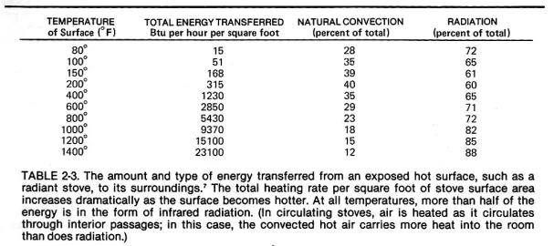

Actually, just the opposite is true. Above 200ºF, the higher the temperature, the more heat is emitted as IR and the less natural convection occurs.
Amplitude in EM is a measure of the intensity of the field, not the wave "height". EM waves are not the same as matter waves (i.e. water, sound), and have no physical measurement (except in wavelength and frequency). Convection occurs because air molecules come into contact with the hot surface and become hotter through conduction from the hot material itself, not because radiant heat strikes the air molecules. In fact, air is fairly transparent to IR radiation, and so is a poor absorber of heat from that source.
For most radiant stoves operating at temps from 400º to 600º, about 30-35% of the heat is transferred via natural convection. At the lower temp range of masonry heaters (about 100ºF), 35% of heat transfer occurs happens through convection. These are not theoretical figures, they are experimentally derived measurements.
