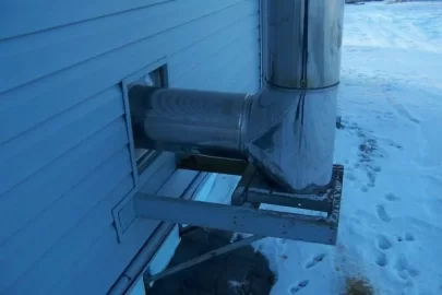

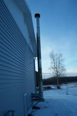

Jotulover said:LLigetfa said:The down drafting chimney is just a symptom. You need to fix the pressure deficit in the home caused by stack effect. Alternately you could install a draw collar to keep the flue warm enough to forward draft.
We did install a Draw Collar and it does keep the cold air out.
