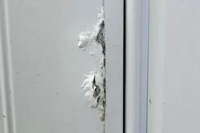

Apparently the core gets wet and swells. Once its wet the cladding rots. I've seen it on some doors just don't know which one.

This is one picture from the HD web site reviews of the Emco. Many more.

Yes i've seen the EMCO doors swell up. My neighbors put a new emco storm door on their house. 3 months later, whatever material was under the aluminum has swelled up twice the size, busted the seams on the aluminum and now looks horrible. They sold the house in between and the new people havent got around to replacing it yet. My own storm door is 4 years old and also from home depot, but it was I think anderson... It was a special order but it looks as good as the day it arrived.
