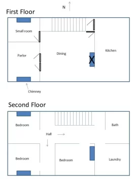

Hello Everyone. I'm trying to decide between 2 stoves, a Jotul Oslo or the Jotul F600. We have a ca. 1870's 2-story brick farmhouse in southeast Michigan. Living space is ~2,000 sq ft. and it's a little drafty. We have a new propane furnace that humidifies and can circulate air, with 2 heating zones - one downstairs, one upstairs. Attic is insulated, walls are not but are actually two brick walls with a 2-inch air gap in between. I've attached a floor plan - the stove would go in the Parlor. The catch is the ceilings are ~10 ft high, and the door headers are ~3 ft, so there's not a great path for the heat to move around. I was originally settled on the F600, but when the chimney guy came to estimate the price of putting in a liner he thought the F600 would be too big because of insufficient heat circulation, and suggested the Oslo or equivalent size. We'd likely put in a ceiling fan, and get the blower kit installed. I know a lot of folks here suggest going bigger if unsure, but I'm worried that we'll be cooked in the room if the stove's too big. I'm also concerned about having too small a fire since it might lead to inefficient burns and creosote buildup. Any thoughts would be greatly appreciated!
