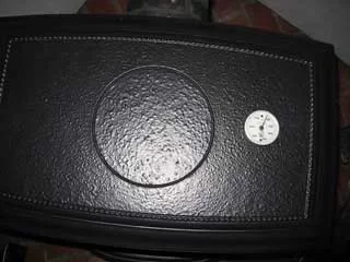

    My stove is rear-vented. I have an old SandHill thermometer placed on the top of the stove to the right of center. Pretty much where the manual recommends it. Unfortunately, SandHill no longer has my style, though maybe if we all pester them, they will consider commissioning a revival model.
