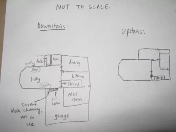

    Coal stoker would HAVE to be used...almost no way, new, and definitely not one that's ready to duct in. The really plain Alaska will run just under $1700 but that's without a power vent, or a hood to tie into the ductwork.
    Don't mind a used wood stove either, as long as it's not been irreparably overfired. The VC could likely be made to work again with about $300 in parts and the better part of a day's work...but it's an 8" outlet...worked fine on a 6" flue up north but code inspection here might kick up more of a fuss. Then again we never ran it with the front opened up.
    Attached is a photo of a hand-drawn diagram. Monday I can scan something if needed.
    Thanks much for your input, and knowing which questions to ask. IMG_0346.jpg

    That looks like it would work with the stove in either location. If necessary a fan can be used to assist convection. It sounds like you have a handle on the process. I would go for the 30NC. That seems like the better long term investment. It'll be cleaner burning and easier to manage. Regardless of stove, dry wood is going to be key to a well behaved, low creosote burn.

    Sorry for the misunderstanding--the drawing shows two possible locations for stoves--I'd only need one. How do you get that price on an NC30 at HD? When I look it up it shows $899. Maybe because it's showing the nearest store price?
    Now to decide the best/lowest cost/least hassle (pick two, right?) way to get a usable chimney. Metalbestos (probably exterior) for the upper--Southern-- location on the drawing, or make a hole into existing chimney and line it (rigid? flex?). How do you clean a lined chimney?
