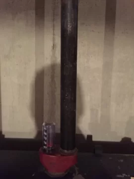

I just noticed after filling my tank the gauge is not working, still stuck on 1/8 tank. The gauge is located in the middle of the tank connected to the vent.
What's my best option? I'd rather not cut the pipe to replace it unless I have to.
Thanks

Your setup looks just like mine.
The whistle in mine quit, so a similar situation. I had to remove the vertical vent pipe (outside), then unscrew the pipe that goes through the wall into the house, then I could unscrew the remaining pipes to get at the gauge/whistle assembly. It took a large pipe wrench and a length of pipe to loosen them, but other than that, it was not very difficult. No pipe cutting involved.
My fill whistle quit because it had some crud stuck in it. I don't know what it was, because just as I reached it, it fell into the tank. Here's hoping it doesn't cause me future grief in there. That whole whistle mechanism is a pretty clever bit of engineering.

I was thinking that but I'm not sure if I would have enough room for the float.
Mine is 22 yrs old and sometimes sticks after a refill & occasionally sticks as the tank level drops. I have an unused port on my tank, so if it sticks during use I can just dip check it with a broomstick.
I would love to install a tygon tube on the side as a direct reading secondary sight glass but something tells me the insurance / bldg inspector folks would have a conniption fit.
Carefully unscrew the plastic sight glass (wrap a heavy rag or piece of rubber gasket material around it before applying the pliers) and the float will respond. Then re-install the sight glass.
Sounds like the float ball is full of oil then.
My bet is that the float fell off the arm.
Not that I can see without removing the vent pipe.
I really have no idea because like I said that is a different looking guage than I used to have. But there aren't by chance say a couple of screws holding it in place, that you access by taking the glass off? Or something like that? Seems odd for a guage to not be more easily serviced, they do get wonky. Some from the get-go.
I have two tanks with that type of gauge and both don't work. I think I came to the conclusion long ago that they need to be unscrewed out of the tank. Some tank installers put a union on the vent piping but most don't as few folks own a set of pipe wrenches that will open up big enough to break a union that size loose. I think most installs require that the pipes be removed from the outside of the house and work your way in. Buy some rector seal in advance as you will need it.
