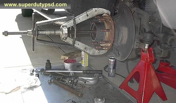

    This is what I did for my Ford (not my pic) But it worked like a charm.
    [IMG]
  10. MasterMech Minister of Fire
    joined: Aug 2, 2011
    4,976 posts
    Hudson Valley NY
    That's the way. Betcha that damn puller costs more than the parts to do the job. You Ford guys are no strangers to hub bearing replacements either. ;)

    I only had to replace the needle bearing for the stub axle - only 8 bucks. Sure beat having to replace the whole hub $$$$
    A cheap $25 two jaw puller worked for me.
