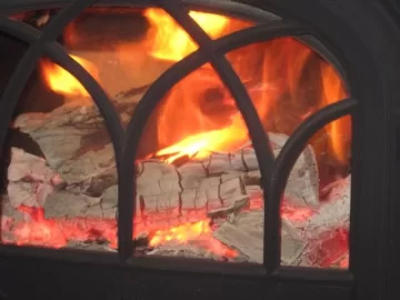

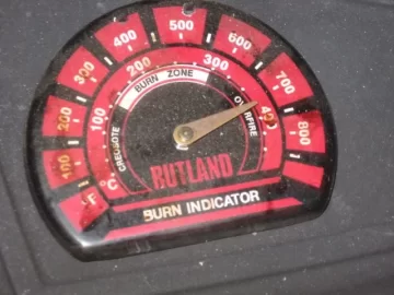

Back in the mid 70's I worked for a small company here that all we did was manufacture Woodland stoves. At that time in my neck of the woods they were toughted as thee best airtight stove on the market. But all they where was a welded up box of 3/8ths to 1/2 inch steel plate with cast doors and the damper knobs on the doors. They were kinda like a model T too as you could get one in any color you wanted as long as it was matte black. I still have a small model of them stoves sittin out back by my scrap pile that is perfectly useable if need be.
I guess I'm just confused about the need for a catilitic thing on a woodstove since we have never felt the need in my neck of the woods.
Even now as I type this I got my Jotul is huffin and puffin away and still aint got a clue as to why burnin wood has to be so complicated. Ole Black Sabbath sure do put out some heat tho with some good old Iowa red elm in it.

I see you have that solidly in the middle of "overfire" on your thermometer.

Nice pictures there of your fire btw - I can only imagine how nice that must feel to get all that heat on a cold day. You have a nice stove there.

Not even close on this stove. I get nervous when I see flue temps get into that range though.

I was worried when I saw those temps on my little 13NC...............that's based solely on the "Danger Will Robinson Zone" on my stove top thermometer. What I realized later was much of that was due to heat soak. My fires were by no means "nuclear". All I had was a big (for the 13) load of wood in her and I probably just dialed her down a bit too late. The secondaries were just cruising. Just to be safe, when this happens, I turn on the little blower motor that came with my 13. Within a minute or two, the stove top is back down to 600* or less. Now when I see those temps; I check my fire, and if needed adjust accordingly.
I have a flue thermometer sitting here just waiting to be installed.
