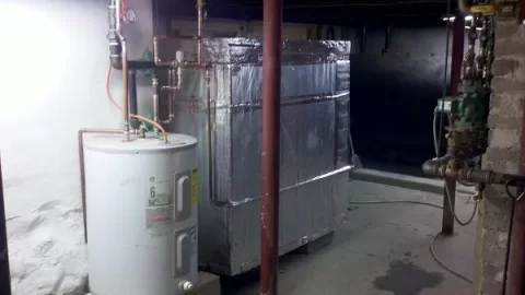

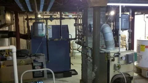

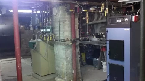

Thanks to those who have helped me in the past. I have not done much posting but I sure have used the info here a lot over the past few years. I hope I have something here to contribute that may help someone else in the future the way all your postings have helped me. What I have is a Tarm Solo 30 with 500 Gallons of unpressurized storage. I followed the pluming recommended by the Tarm folks in Lyme NH (Not so far from where I live). The tank is a square stainless steel 1/8 thick with a lid I found on Craigslist. I added 4" of yellow insulation to the outside. I have 240' of 3/4" soft copper coils inside and another 180' for domestic hot water. I have a back up oil boiler. 4 zones but only 3 being used currently. (all baseboard) I have a 40 gallon electric water heater I plan to switch to a Superstor that will run off my 4th zone. You can't see it in the picture but I had to add a new chimney so that delayed my install. I fired it up for the first time on Saturday and it is running great. Questions...
I find my internal flu temps will not go over 400 even with very dry wood. Is this normal?
I have my aqua stat for the circulator set to 160 and as a result the boiler and the storage never seem to go any higher than this. Should I consider something a little higher to get hotter temps into the tank?
My fan does not shut off until long after the fire is out. Should I increase my low limit?
Thanks

Allllllright! Waaaahoooo! Congrats on the completion of the install! Nice looking setup. There are several of us with new systems and I am psyched! Amped! Can't stop thinking about it! Okay, sorry. :-/ I will settle down now. Enjoy man.
Yes this is normal. That partially shows you how efficient the boiler is. The temps in your lower burn chamber are 1500-1800 + degrees. My flu temps are usually 275-375 degrees on the outside of pipe. So obviously higher inside. But still good.
How big of loads of wood are you burning? What size splits are you using? Is the wood dry? Your boiler and tank should go up to 175-180 easy depending on what the high setting on the boiler is. May have to burn longer and hotter. I will defer to more experienced people on this though. But my circulator is on at 165. My system is pressurized and no coils though. So a little different.
I do not have a shut off for fan on my unit. So I can not comment on that.
Good luck, and again. Nice set-up dude. Sweeeeet!
