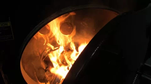

tell me about boiler temps and pump flows- i talk better than i type  btw.. I just fired my boiler for the 1st time ever on Friday moirn the "paperwork" said to set the boiler to 180 @ 18 psi and a 10 deg differential ...... why ?? I set it to 170 and then the 10 ...and the psi hangs at 20,( both the gauge that came with the boiler and my aximon boiler tender), thing is when the boiler shuts down after a call for heat the temp climbs to 175 and stays there... I've had to only add wood 1 time since Friday! 21 to 12 deg outside temps, heating a 4 zone slab in 1200 sqf shop (70degs in here is a bit much !) last call for heat in the shop was Saturday morning at 9am the again last nite at 2am I have two pumps both GF one regular 3 speed after my 4 way valve to run the zones and one the alpha that pumps from the boiler thru the 4way and back .... I put the alpha pump in auto-adap and it burms 43 watts and pumps 11 gpm ...with no call for heat ........... seems mighty high for a pump just pushing a loop with no calls for heat .... how to go about setting the "speeds" and what should I be looking for in return temps (of the water coming back into return ) I have my 4 way set to supply temps between 85 and 110 on a outdoor reset, my return boiler water at 140
