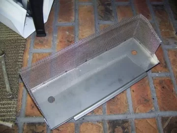

I wonder if the Blaze King's need a different scoop or screen in front of the s/s cats to keep the fly ash from plugging up the cat? Probably why Woodstock made this change? I know very little ash if any gets through the new Woodstock s/s scoop.

after reading this i think ill stick with the ceramic one. i thought i had heard that other people with the bk had trouble with it getting clogged.bogydave said:My S steel one plugged pretty fast when I was burning spruce, finer honey comb, I had to remove it to vacuum it out.
Got a ceramic & now have the SS for my spare.
The ceramic has larger holes & it lets the smaller ash/sparks pass thru better.

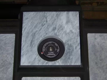

Todd, I bought a catalytic thermometer (condar) and installed it this evening. Some information about that below. But first, my experience drilling through the fireview top to install the thermo.
I intentionally used a worn masonry (carbide tipped) bit thinking that slower would be better. The stove top was about 125 degrees. I drilled slowly and drilled through the stone stove top in about 10 seconds! Soapstone is SOFT. From there, the little sleeve slipped in the hole and the thermo in the sleeve. Very easy to do.
Now, after starting a fire from a few coals in the firebox, I got the catalytic up to 500 light off temp in about 20 minutes. The surface thermo was saying about 175 degrees. I closed the bypass and am watching the cat probe thermo go up, up, up. Amazing that I could go to catalytic so quickly. This is good information, as there are frequent times when I reload a warm (but not hot) stove and have had to wait for the 250 degree stove top temps. Now I can go to bypass faster. I'll be interested in how I can operate the stove with this additional information.
Don't be afraid to drill into your Keystone. Easy to do.

Drilled through mine about 2 months ago. Didn't have to go through the soapstone, I went through the top venting plate. I also have found quick light offs reaching cat temp in 15-20 minutes while the stove top is only around 150. Let us know your cat temps compared to your stove top. I may for go the stove top temps all together and just watch the cat probe.

Couldnt us BK owners make our own screen similar to what Woodstock has?
