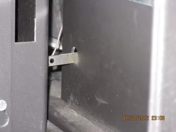

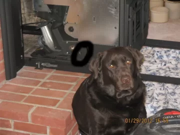

    Take the left side panel off and the slide damper will be accessible! Although the stove is pulled out in the second picture, it does not have to be to adjust the damper (slide damper is circled, I use an awl to adjust as the slide is hot as F'...fool me once!). First picture the stove is not pulled out!

    Thanks for the pictures! Is there anything else I need besides a magnehelic gauge? There is a used tool shop on the Berlin Turnpike. I'm thinking about heading over there to pick one up.

    That should do it...Just remember to run your stove at level 5 for about an hour before you set the slide!
