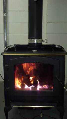

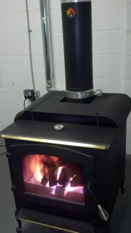

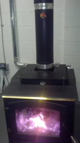

    I made a convection deck for my 30-NC
    Started life as .040 piece of 1055. Then I added a few bolts to level it.
    Then cut a 4" piece of rigid dryer vent in half and screwed to the plate.
    Then painted it all black. I only use it when I run the blower. It helps to run the air directly across the top of stove, rather than shoot it up on a 40* angle like the deflector on the back does...
    I only did this a little while ago. But after 2 yrs of running the stove, it seems to make a huge difference. Mind you I am running from the basement :(
