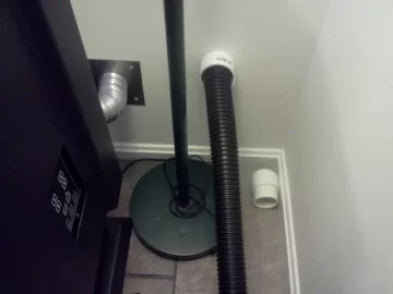

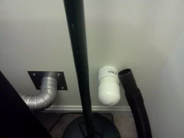

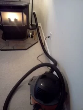

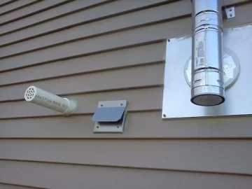

1) Exterior exhaust vent for the wet/dry vac for ash cleaning. I figured instead of constantly replacing expensive HEPA filters, I vent the vac exhaust directly outside. I drilled a 2.5" through the wall and ran a 2" pvc pipe through it, and this pvc section is held in place with a pvc coupler on both ends. My 1.78" vac hose fits perfectly into the 2" pvc pipe. I placed a drain cap at the outside end to keep critters out of pipe. Also, I plan to use this access to run an extension cord through when a generator is needed.

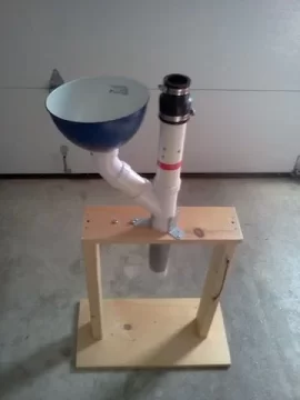

2) The pellets I've used so far has been very dusty, so I built a pellet "cleaner" with mostly scrap materials I had on hand. Just spend a little bit of money on the pvc tubage. Don't see any more dust when filling the hopper.
I've been using the same HEPA filter going on 3 years now,,,, every now and then I just take it out and tap i around,,, it seems to clean up really well,,,,, but I do like the idea for the trough wall,,,,,,
John
Nice job on the PVC through the wall. Thats a good idea. But my filter has a lot of life in it and if I put one more hole in the side of my house. My Wife will put a hole in my head!.
Looks great. Pellet Sifters work great. Love mine.

LOL I was reluctant to tell my wife about this exhaust project until after it was done figuring I'd get that very same reaction, but I did ended up telling her before doing it and she was totally ok with it. I think she has a lot more faith in me now after seeing how well my install came out and how well the stove has been working. Plus, she probably love the idea of venting all those micro-ash out of the house.

Well you did a good job. Everything looks good, all the way down to the OAK install.

Great idea on the vacuum vent.. I made a big mess the other day. I had been using the "bags" and they seemed okay. But they weren't! Got a HEPA now...
Pellet sifter looks great too. Makes less of a mess in the house and i'm sure it does something else good too. I know my 5 year old loves to dump the pellets in. LOL!
I have to build a pellet sifter...The pro-pellets are full of dust. Somerset's, not nearly as bad. Used to fill my dump bucket in the house, Now the wife has banned that, and I have to fill-up in the garage. May steal either your or Dexter's pellet sifter idea!
If you ever need help. Just ask. Im only 20 min away. Wont let you have mine, but I will be more than glad to help. I have plenty of gutter gaurd and 1/4" dowel rod left over, along with some PVC. That would be of "No Charge" . Just a couple beers..... ;-P
Very nice set-up....cool idea to add the outside cleaning port for the vacuum.
The pellet cleaner will almost eliminate any build-up of fines in the auger or bottom of the hopper.
