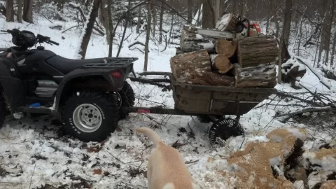

    Decided my ATV trailer needed some modification
    to make my wood transferring a little more productive.

    Your pic is upside down, looks like a nice mod to the trailer.

    I have what appears to be the same trailer, and I've been meaning to do this same thing. Are those off the shelf firring boards that fit right in the pockets?

    Yes, I went to the Big Box and bought them; they are a little snug but I used a rubber mallet to convince them. I just used some wood glue and my brad nailer for the connections, figure out your spacing and cut a couple of end scraps to use as height gages, I made mine stick out of the trailer about 12 1/2" then made the spacing equal, say 3 7/8", used some old furniture L-shaped brackets I had laying around for the corner joints where the wood meets.
    Yep, I noticed with the Rubicon and the trailer loaded to the top of the extensions that she tends to "push" a little in the corners!

    Aside from a little extra groan taking off and a little extra stopping distance, I don't really notice the trailer back there when loaded down...but I'm not really going fast enough to really notice though.
    Now, with my 4x8 HF trailer with 24" sides loaded to the hilt, the front end of the Rubi plows when in 2WD...but there's a good 1,500 lbs on the trailer so all things considered it handles it pretty well.
