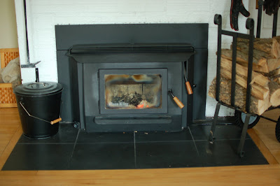

    Do ya think my cat temp might be effected by only 13 inches of the pricess insert sitting out on the hearth, and the rest of the insert behind brick?

    Hi Lanning!
    Now that Beetle-Kill has paid his last regards to this thread, we can reanimate it for our own purposes! ;)
    Knowing nothing about BK's specific engineering, my WAG is "Yes, but not so it matters."
    Unless you've somehow violated BK's instructions in your install, you're operating your stove as designed, so I'd have no worries.
    In other words, I doubt there will come a day when you'll have to tear your flaming insert out with a mighty roar, carry it over your head and throw it into a snowbank. :)
