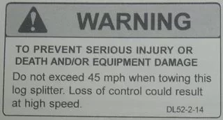

G6 at Snook said:I noticed that Ariens has had trouble with towing their splitters. I have the Iron and Oak 26ton. I don't go flying down the road, but hitching it up to my truck is a plus. Am I in the wrong here? Do I need to trailer queen it?
Thanks.
