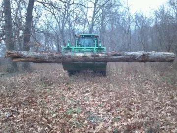

    Well said MasterMech. Always properly ballast a tractor with a FEL and install a ROPS if not equipped. This 7320 has fluid filled rear tires and 900lbs on each rear wheel and things can still get wild. 2011-11-27_12-56-15_159-1.jpg
