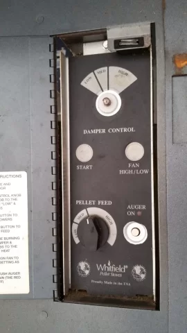

I recently purchased a used whitfield quest wp4 pellet stove insert from a family member that I am getting installed next week. Everything looks like its in decent good shape, except the control board is a bit worn and is missing the knob for the damper control.
I've looked around online, and it seems everywhere online that seems replacement control boards don't include the damper control, its just an empty hole...plus, as far as I know the control board works, just one of the buttons is worn, so not sure its worth the $300-400 for a new control board.
Does anyone know where I could buy a replacement knob? or at least something that would fit?

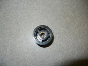

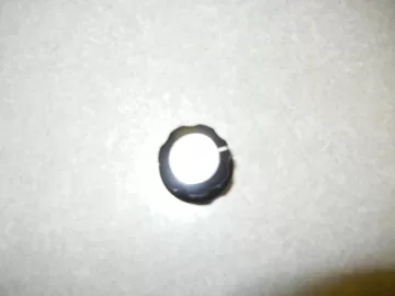

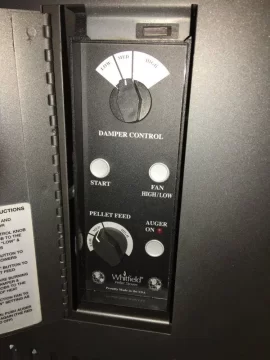

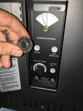

I just got a brand new Quest Control Panel from Whitfield and that only comes with the pellet feed knob. In my pics below the brass ring that holds the OEM knob comes off by loosening the set screw. The shaft is a standard 1/4" with a flat spot so a common knob like Bioburner suggested should work fine if not better. :)
Pic 1 - OEM knob on control panel
Pic 2 - OEM knob off control panel

Looks like the control panel membrane has been ripped of your "Auger On" button and the brass ring on the damper shaft is missing?
