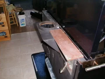

    Here's a picture of a half inch thick aluminum plate across the back of my kitchen cook stove and heat source in the house. A 24 gallon water tank sits on it, and this moves the heat into the tank with better heat conductivity than steel. It gets another piece around the outlet cut in a radius to fit the pipe. This extracts the normally wasted heat around the stack and transfers it into the water with increased area of tank contact. A second benefit is keeping the area where yours shows fatigue cooler.
