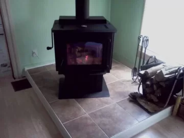

Here is what it looks like know that I think we figured it out (its a beast man).
