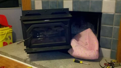

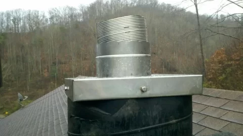

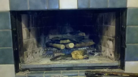

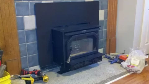

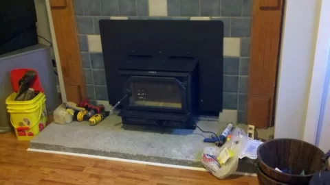

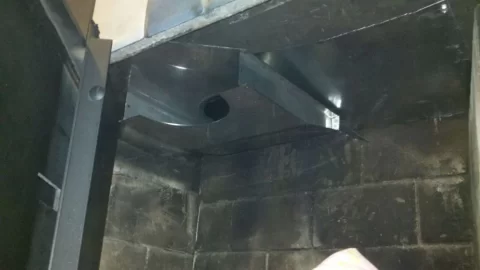

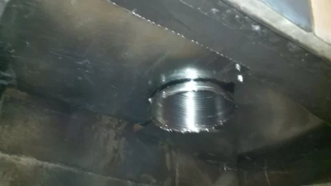

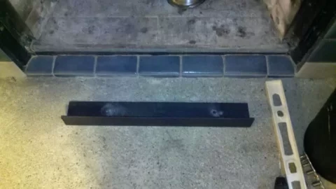

I now know why everyone says to have at least 2 people when installing these things. It's has absolutely wore me out this weekend. Here's pics of the install, start to finish. The big issue I had was the clearance between the stove and the bottom flange of the offset box. I had to cut part of the flange off and roll it back. That made it next to impossible to hook the offset box up to the stove. Luckily it's wedged in there...tight. I then sealed it with stove cement form the inside, it's not perfect, but it's as good as it gonna get. Any advice for the first few fires? I might try burning tonight. And again, thanks for all the help here.
