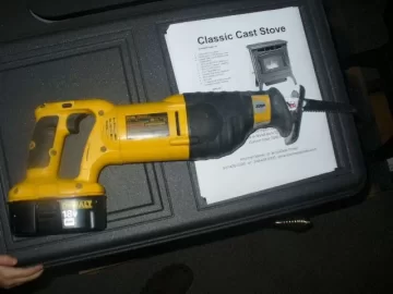

I draw the circle, use a couple pilot holes with a 3/4" or 1" spade bit and connect the dots with a saw zall.
Eric
  • what size hole saw for pvp 3" wall thimble?
