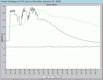

    The whole storage thing is quite a topic. Some people claim dramatic efficiency improvements, and that may be true if the alternative is idling a big boiler most of the time. IMHO, the best solution is to size the wood boiler so it's just barely big enough (as the previous post suggests) so that it burns as much of the time as possible. Then if you can, use storage to allow you to space your fires according to the weather. Here in Vermont we're having a warm spell. I've skipped two days in the past week. I did run for a year without storage, but life is better with than without.
    Basically, I needed my small boiler to burn flat out for about 8 hours out of the last 48. I did that with three 'chained' fires during the day on the 6th. Each fire ran flat out, then died. I restarted from the coals each time. By the end of the third fire, my tank was hot enough to carry me through the entire day on the 6th. It's now the morning of the 7th, and my storage tank just ran out of usable heat. I'll probably build another fire this afternoon.
    The alternative would have been a lot of smoldering or much wider temperature fluctuations in the house. This would be more of a problem when it's not bitter cold outside - when the heat load from the house is way less than the boiler's capacity.
    I've attached a graph of the last 48 hours showing boiler output and storage tank top temps. The lower black line shows the storage tank circulator pump cycling to heat the house. At the end, it's running flat out and can't keep up, since the water in the tank is too cold to provide enough heat.

    I did not realize you needed to fire 3 times to get your storage charged. Would it be benificial to be big enough to have the ability to get completely charged on one burn
    for the size of the storage? The black line on your graph that is really wild- is this the pump? Your pump is different speeds, or it would be just an on/off line?

    The three firings were not full loads - I was trying to spread the heat out over the day, and we were out for a bit longer than I expected so it almost went out the first time. I usually burn one single fire, an initial 3/4 fill followed by a full load, about 7 hours burn time.
    The squiggly black line is the boiler outlet temp. It jumps around based on heat load (whether I'm heating the storage tank, for instance).
    The horizontal black line nearer the bottom is the tank circulator.
