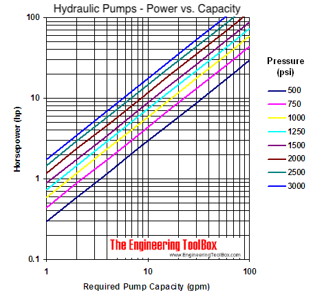

As far as engine, here is a chart of hp:
Which hydraulic pump to buy
Notice that above about 1500psi, you need engine hp equal or greater than pump gpm. So a true 11gpm pump will need 11hp engine, 16gmp=16hp, etc. For log splitters, you'll usually find a 2 stage pump which has a high flow under low pressure to move the cylinder fast, but will shift to a low flow at high pressure to power through tough wood.
