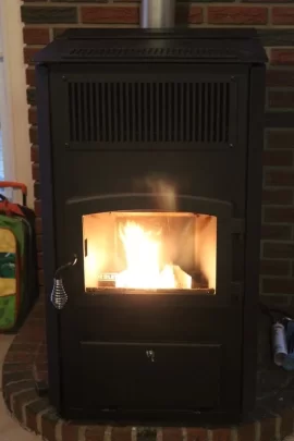

    Enjoy the heat.

    Very nice...
    But one question? Is that concrete in front of the brick hearth? Or tile?
    Or is it Carpet? Hard to tell? The ember protection is normally several inches in front of stove.
    Also, make sure you have it hooked up to a good surge protector.
    Looks great. The Drolet is a very nice unit. Burn pot like a Harman, with a softer price point :)

    It's Tile and was W.E>T.T. cert with a wood stove so it is good to go with the pellet

    Thats an awesome heater. Do you plan to duct the heat with there Duct system they sell?
    As for the tile, I see a grout line on the left now. Looks like a very nice Hearth. Any pics from further back?

    picture above no duct
