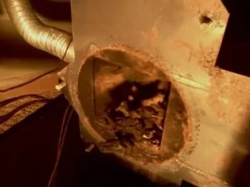

ok got it off, now another question.....where we took that off and the hole thats there once you get it off, is stuffed full of insulation (black soot insulation)???

Hopefully this will be readable.

Now this is where your combustion blower (looks like the housing to me) was attached?
Well that is sure a good blockage from where I sit.

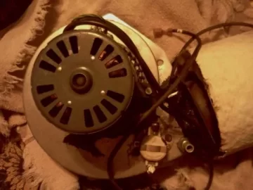

yep, do you want a pic of the insulation or the blower that I just cleaned out with a air compressor, that's how bad it was, there was also a piece of that insulation in where the blades are...

If that is the exhaust path the answer is no, it looks like a mouse or squirrel built its nest in there I want to be certain what shape the rest of the exhaust system is in.
Blower picture.
When you get the stove back together you should attempt a leaf blower cleaning. I suspect you have additional crud in the system.
Now this is important what color is that insulation?
And exactly how much more is in the system?
I don't want you pulling out any insulation that should be in there but for the life of me I can't figure out why any should be in there at all.
Can you tell what the color of the insulation was originally.
