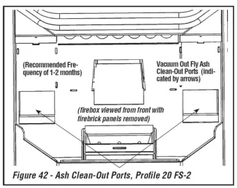

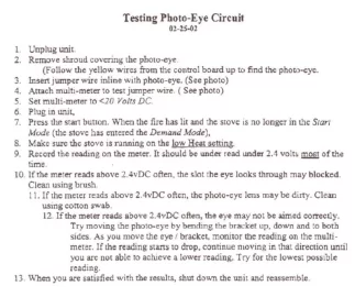

    Go for it! $200,- is a real bargain. A Profile 20-2 is an improved version of my Quest Plus and I have only good things to say about mine. One important improvement is the ash clean-out ports behind the fire brick. See photo. Some people have had issues with proof-of-fire sensor - the photo-eye -, but if you follow the measures as suggested in the text below the photo-eye shouldn't be an issue.
