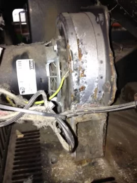

    I purchased this stove a few days ago, I'm having issues finding the adapter that goes from the exhaust blower to the 3" pipe I'm going to use. I've been to 3 local stores that carry Whitfield parts and they have no clue what I'm looking for......even with pictures?
    As you can see, it's a rectangle opening on the exhaust blower but needs to attach to a 3" pipe........ I'm in need of locating the adapter that goes here, can anyone help me?

    This is a piece that comes with the blower. Dont know if they are sold separate.
    I would definitely take some compressed air and blow that motor out and oil it (Well).
    Does the blower still turn well? Bearings still good (bushings)?

    The blower turns just fine, the picture makes it look worse than it actually is due to the flash on my phone........I'm in the process of cleaning the entire internal workings of the stove, I had it running outside just the other day to make sure it all worked as the guy I purchased it from said the auger motor was bad, once I cleaned out the auger shaft and put it back together everything seems to work great.
    I have seen multiple sites that have the replacement blowers but none have the adapter piece I'm looking for in the pictures with the blower?

    I have the same stove and looking behind it there is an adapter that is missing in your picture. As you stated the stove end of the adapter is square and the vent side is round. This adapter is a separate piece and screws onto both the stove and the vent.

    What you are looking for is called a snout. It would have been sold with the blower and is not a seperate part.

    Pm your info....i can scrounge the wreckage...i have something i can send you
