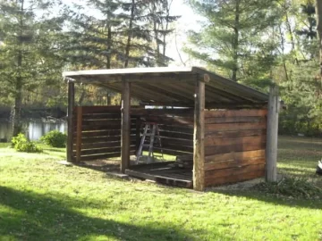

    I built a rustic wood shed out of logs.
    I havested standing de-barked logs for the post and beam construction.
    I conected them with metal straping and barn nails.
    I errected them on reclaimed sidewalk slabs.
    I used re-cycled 2x6's for the support.
    I sided it with Red Oak, which I purchased really cheap from a local sawmill.
    Then I put on a metal roof on purchased treated 2x4's.
    All in all it has worked out really good. Keeps snow off but still ventilates.

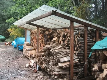

    This holds 3.5-4 cords. No plans, but very simple to make.

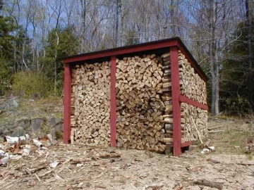

    Just keep it simple... some sturdy posts and a roof will get the job done. This will hold just shy of 8 cord:
      File size:
      117.5 KB
      Views:
      557

    That is the most tightly packed shed I've ever seen in my life! Nice.
