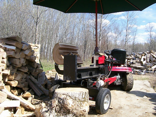

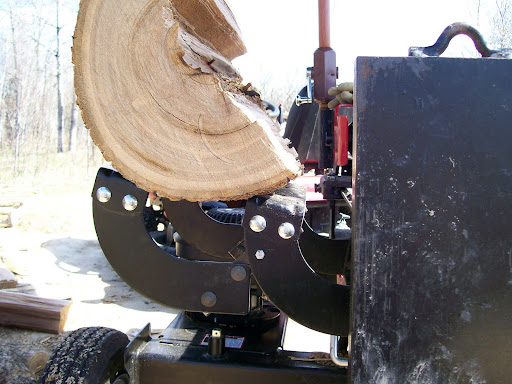

    There were a couple of annoyances with my splitter. One was that the log outrigger on the work side continually dug into my thigh so I took the damn thing off. The other annoyance was that the split half on the far side sometimes teetered over the far side outrigger and I got tired of having to stand a couple of large rounds on that side to catch them.
    So... I've been looking at the work tables that some others have made and thinking that would be nice. Then I start looking at the removed outrigger and figured I should be able to sister it up with the other one and so YASM was born.
    The requisite pics and a couple of gratuitous ones too:
    [IMG]
    [IMG]
    [IMG]
    [IMG]

    Thats thinking! and i like the way you work

    Ja, I'm both cheap and lazy. Two small pieces of flat stock, ten holes drilled, and two bolts. I didn't have any short 3/8ths inch bolts so I had to use one 1/4" bolt and one 5/16th inch bolt until I get to the store.
    I'm not looking forward to splitting that huge burl in the second pic. Serves as a handy side table in the meantime.

    I know what you mean but noodling is like accepting defeat. My splitter can convert from horizontal to vertical for the really big pieces but if I can lift the round, I will. I use a P-handle dolly to bring the really big rounds to the splitter. If I then lay the handle down on level ground, the log wants to roll toward the handle. I need to set it on something just high enough to stay put so that I can safely lift the round from its slightly elevated position and not have the dolly cut loose and trip me up.
    My next mini-project is to put a hitch receiver and pintle hook on the underside of the beam at the base. Then I can captivate the handle of the dolly and it stays put while I lift the round off.
    I want a hitch receiver anyway so that I can hitch up my dolly or a trailer behind the splitter and tow them both in one shot.
    BTW, that poor man's work table holds the umbrella nicely in the stowed position. A couple of bungee cords, a gas can, the umbrella, and I'm pretty much set. Just need a spot for a cooler full of beer. That's where the extra trailer hitch would come in handy.

    That had to be painful bumping into that cribbing all the time...excellent idea moving it to the far side. I can see how it way more work friendly now, good job on the YASM LLigetfa.
