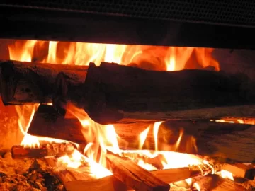

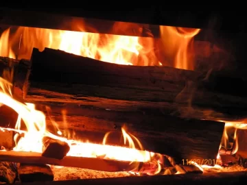

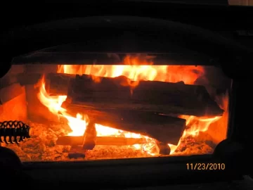

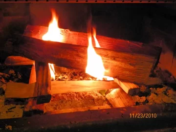

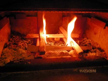

    Kindling with firestarters then once they get going add some smaller splits then some bigger smaller splits and it's off to the races.
