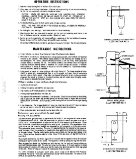

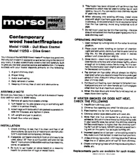

Attached is a manual for the 1125 and the Morso Handbook for old Morso stoves.
