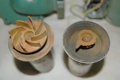

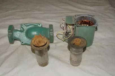

I had a Taco 007 that wouldn't pump water and I had another one with fried electricals. Between the two, I have a pump that should work.
Not sure what happened to the impeller to the right. I ran it in a potable water application for 7 or 8 years at temps that routinely exceeded 200 degrees. But the bearings are still OK and I think the pumps are rated for 240 degrees max.

Well, I hope impeller parts have nutritional value. :-)
Now I have 3 spare 007s, two of them brand new, and a new three-speed Grundfos. So I'm really not in the market for any more pumps.

That was a plastic impeller. It was the pump I used on my old system to pump DHW between the tank and the coil. That's one tough pump. The whole time I ran it in that house, it was mounted wrong, with the can pointing down. I didn't know any better. It ran like that with no problem for about 6 years. Never had a problem with rust stains in the laundry, and the body is in surprisingly good shape, albeit a bit rusty. I'm thinking the impeller degradation might be cavitation, though I doubt that running it mounted wrong would cause that. Maybe water flashing to steam against the blades at high temps? Debris in the water?
Anyway, I guess the moral of the story is that just because you can hear a pump running doesn't necessarily mean that it's working.
high temperature and cavitation would be my guess. Erosion wear is what it looks like to me.
What pressure was the system running under? All centrifugal pumps run better with a bit of pressure on them. Most pumps have a listed NPSH number (net pump suction head).
At 190F you need min um 4 psi inlet side, at 230F 15.6 psi. Temperature makes a huge difference as you can see. This is from the Grundfos submittal data sheet for a similar sized circ.
This is my biggest pet peeve with un-pressurized OWF with high head circs. Assuring that NPSH in many installations is all but impossible.
Throttling down the pump, either on intake or discharge coaxes them to cavitate, also. Plugged y strainers are a big cause, gross mis- sizing also.

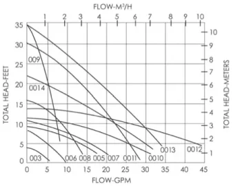

A 007 on a 1/2" short line must have been developing some fairly high velocities (fps) considering at a couple feet of heat it's trying to move around 10GPM. Way in excess of what a 1/2" line will carry, and possibly part of the cavitation problem.. I'm surprised it didn't wear through the copper tube or any ells in the system. A 003 may be a better choice. Or trim the impeller on that 007 :)
