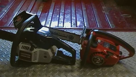

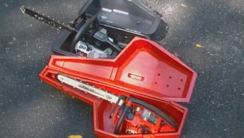

on a side note, came across an add on CL "one craftsman chainsaw runs great. could use blade sharpening or use as is. has a case. other is a homelite and it doesnt run dont know why. also has a case. asking 100$ for the pair"
i offered him $20 for the homelite as i wasnt really interested in the craftsman. he said ok, as long as i take the craftsman also. sure, whatever. picked them up, didnt look other than a glance that they were in the case.
checked them out a bit better this morning and cleaned them up and sharpened chains. craftsman chain was on backwards. runs great! suprised me actually after i took out some sort of very restricting plate in the muffler. with plate, exhaust only had about 1/16" to travel through after it when through flame screen.
homelite had the return spring in the trigger assembly knocked out of place. fixed that and started up first pull with fresh fuel! gonna ask that guy if he has any other old equipment that he wants to get rid of...

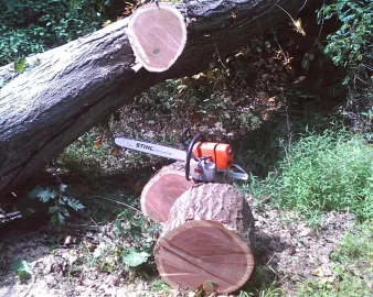

this tihng is AWESOME! not too heavy for how i intend to use it. im gonna say that i dont even think it drinks too much fuel considering the ammount of chips it makes. definatly a happy guy here.

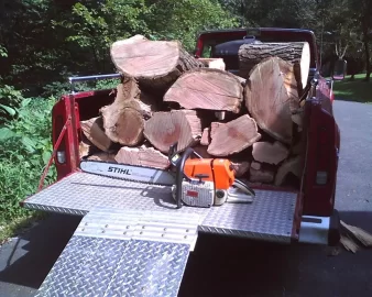

Looks like you were making use of those bucking spikes - essential on a high power heavier saw.

1987 JEEP J-20. when they made them they had more ground clearance and a lower center of gravity than any other stock pickup. 38k original miles. originally was a fire department truck. it is an awesome vehicle for hauling rounds out of the woods. 3/4 ton, 360 with dana 44 front and full floater 60 rear. my brother and i are AMC guys. trying to finish building a CJ-5 also...
here is a couple pics from last winter.
