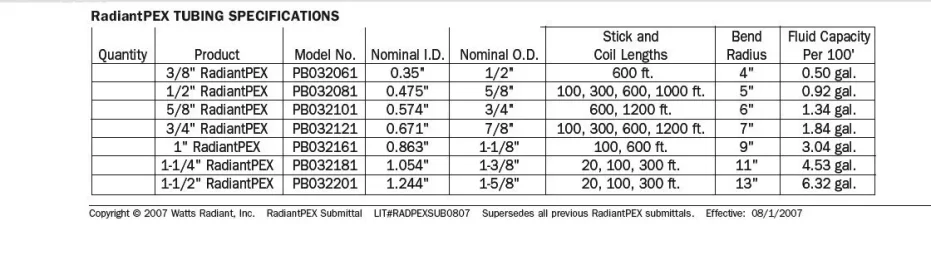

I've used 1-1/4" Pex from Watts Radiant. It is not a PexalPex tube, but basic barrier pex. They offer it in 100 foot and 300 fot coils, as well as 20 foot straight sticks.
It's a bear to work with. Use it when it's very warm :) like today.
They offer regular crimp fittings, but they have dual o-rings on the fitting to seal better. I use an electric Press tool to squeeze the rings.
And yes it is a smaller diameter then 1-1/4" copper tube at 1.054 id. The od is the same as 1-1/4 copper tube, called CTS for copper tube size.
The Watts website does show 1-1/2" pex. But I have not seen fittings or used this size. It has a 1.24 id, close to 1" copper.
I suspect if you dig at their website you might find pressure drop and flow charts for the various sizes.

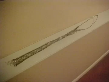

Borrow or buy one of these wire pulling deals. It works like a Chinese finger cuff :) The more you pull the tighter it gets. It has a nice smooth loop end so as not to get hung up on the ridges.
For a long pull two guys, and possibly a block and tackle may be the best method.
